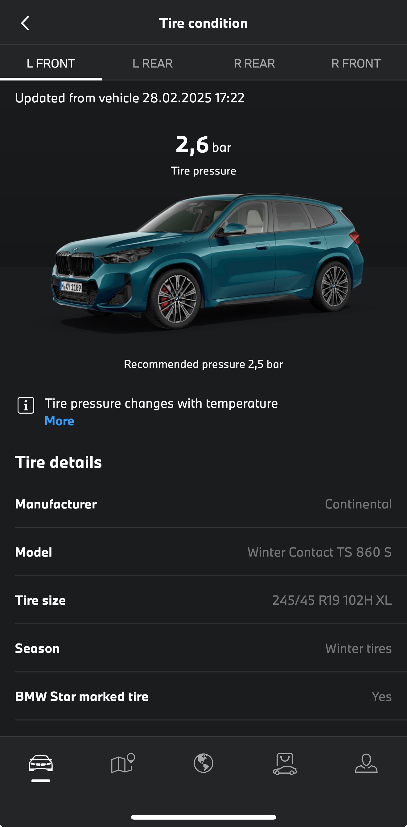

My car has 20" BMW Individual rims with Conti 6Q MO 245/40 R20. I am 100000% sure that they were never changed as this is the first winter for this car (it was manufactured in may 2024) so no need for winter tires.
But my BMW APP reports Continental Winter Contact TS860S 245/45 R19 and recommends a different pressure.
Any ideas how this info is generated ? From where ? Sensors are "dumb" , they have no idea about tires

You go to the pressure monitor indication in the car, and switch from auto recognition to manual, then select the tire you have from there, then finish initialization by driving

Back with my "coasting" question. So it seems that the car doesn't coast because:
it has 20" 245/40 R20 summer (Continental) which needed to be 2.7bar
it sees 19" 245/45 R19 winter (Continental TS860) which needed to be 2.4bar.
I tried to set them to "auto". I've set them manually 245/40R20 but the car insists it has winter 245/45 R19
I tried to lower the actual tires to 2.4 front and 2.2 rear (as indicated) but it's clear to the naked eye that something is wrong. BMW states 32psi / 2.2bar for all 4 on X1.... mine is diesel, it has 1.7 tons and it cannot run on 2.2.
Any ideas ?
