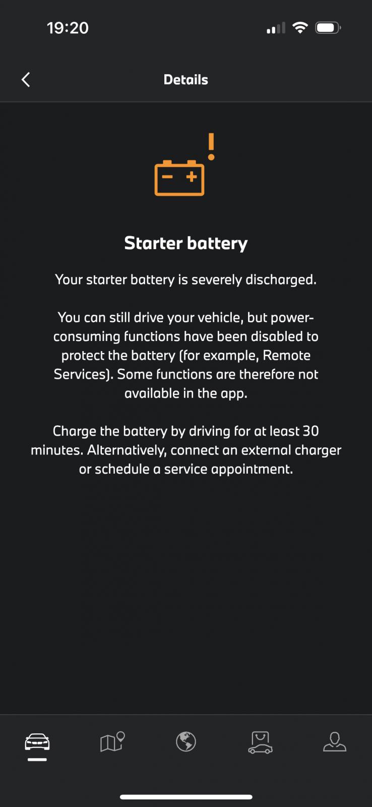

Starter Battery Message
When I opened the My BMW app tonight the message below appeared. As a result I went for an impromptu 30 minute drive.
My theory is that am using Digital Key in my phone, haven’t driving in a couple of days, but I walk by my garage multiple times a day, each time which causes the car to wake up and then shut down. Which i also am made aware of because the digital key in my Apple Watch taps my wrist when the car locks. The power for this activity has to come from somewhere hence the low battery message.
After seeing that message I went for a drive. The car started fine. The message went away after 30 minutes. When I parked tonight I put the car into deep sleep until I figure this out. Now to play with settings to try to stop the unintentional waking without disrupting the convenience of the car locking & unlocking based on proximity. Or get a trickle charger for when the car is parked.
Interesting. I haven’t had much time with my X1 yet, but so far I have to be within 6 feet for the car to unlock itself. I can see how this would be annoying if you have a house with attached garage, since you’d be more likely to trigger the sensors. Thankfully I live in a condo, so I don’t think I’ll run into issues.

I believe I saw in the settings section (Doors and Windows?) where you can specify how the car locks/unlocks itself. I recall changing mine to know when I walk away from my car to automatically lock, and it does the same as I approach (unlocks).
I do not have a cool Digital Key though, so I'm not sure if that is different or not...but I am curious as to where you get the Digi Key. Mine is a US Spec but living in Italy, so unfortunately, I'm unable to connect it to a US system for unlocking CarPlay and other things.

Also forgot to add that mine shows "Battery Replacement" when I picked it up w/only 64 miles on it. The European dealer told me that it just needs to be driven more for the alternator to charge it up? No clue, but I'll give it a week or two and if no change will have it looked at by the local BMW.
Yeah - another reason I deleted the digital key from my phone. My laundry room is next to the garage, and that is within range of the car in the garage. I carry my phone with me in the house, but not my key fob.

How many times do you walk near your car to make the battery drain. I am worried about the battery quality. Like @OneAnOnlyOC mentioned in his post about the replace battery msg, only 64 miles and the battery already drained?
You could just disable the auto unlock and still use the digital key though, right?
I don't keep the car locked in my garage; I have auto lock disabled. It doesn't change the fact that the key is detected within range and wakes the car up every time.
Ahhhh, gotcha. I’m gonna have to play around with my settings. I went down to the car a little while ago to grab something I forgot and the car woke up and started the stereo just by opening the door, not sure I like that. Especially because it’s 3AM here and quiet enough to hear a cockroach fart.
I hate that. You either have to mute the stereo by quick pressing the volume knob before getting out of the car, or actually shutting down the screen by long pressing the volume knob. For 8 years, I hated the double press of the ignition button in my F30....and now I miss it....
Fully discharging a car battery is generally a bad thing so seeing this message on my phone didn't give me the warm & fuzzy feeling though thankful for the advanced notice.
