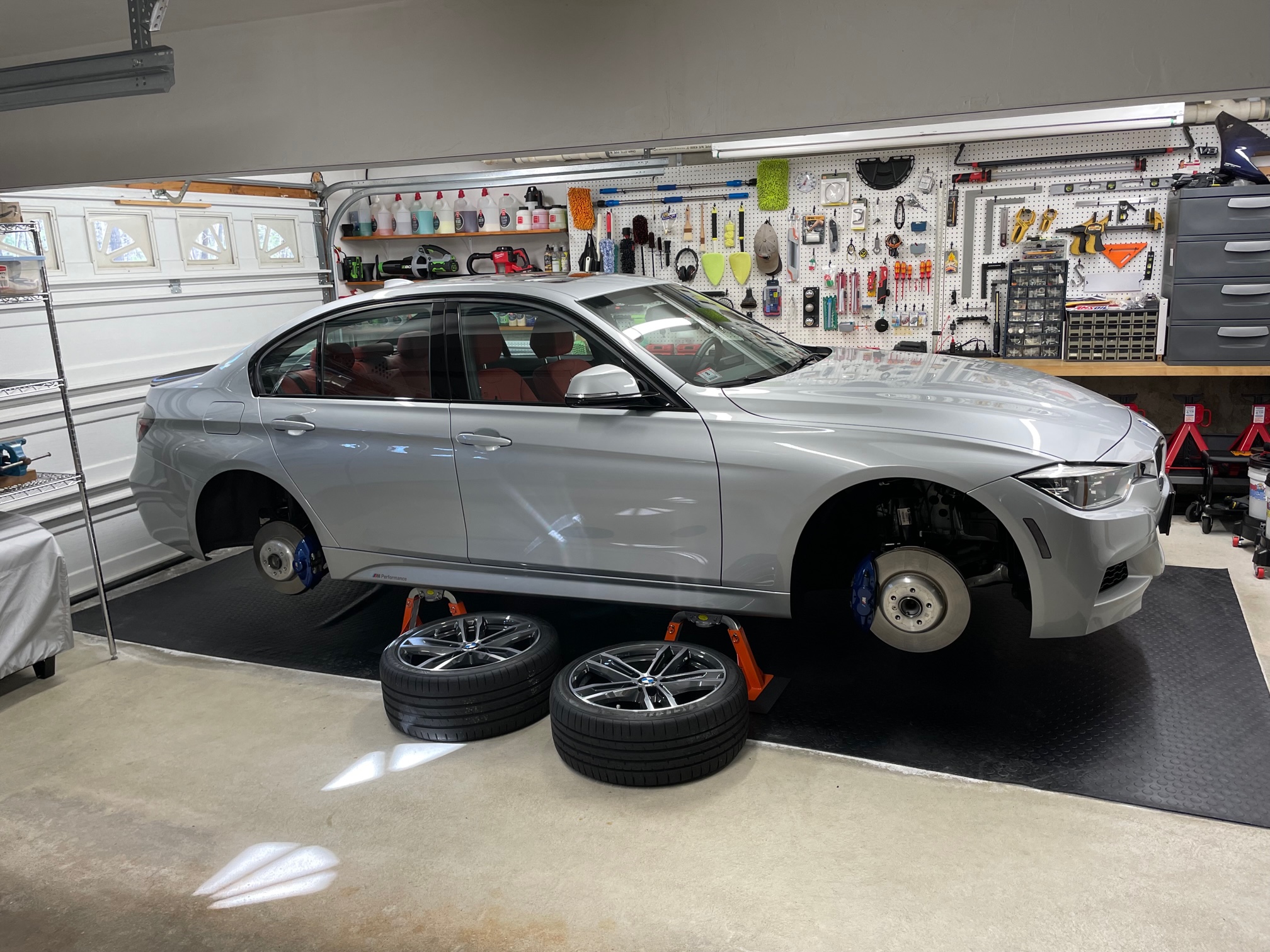

These jack stands are really slick!

Thanks... Money well spent!

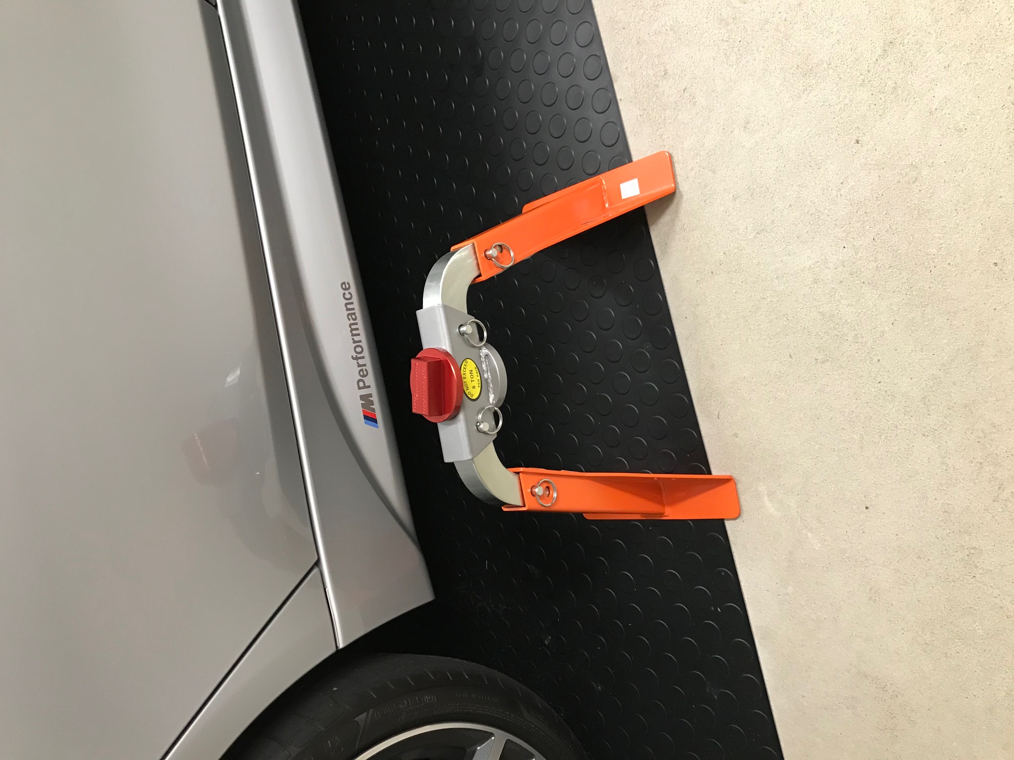

Where did you buy the red jack pad adaptor for the Rennstand?
And where did you find a jack that fits under our cars with the Rennstands?

FYI you don't need them if you're worried about that. BMW shop manual doesn't have special tools to use with the lift blocks, just the flat of jack or lift arm.

It’s a modified Burger Motorsports (BMS) jack pad. BMS is one of the few manufacturers that has a jack pad with the correct height so that you’re not crushing the car’s plastic receptacle. The modification is drilling and tapping a hole so that I could mount a 1/4-20 bolt and spacer to act as a positioning stud when sitting on the Rennstand. I use a low profile floor jack to lift the car.
