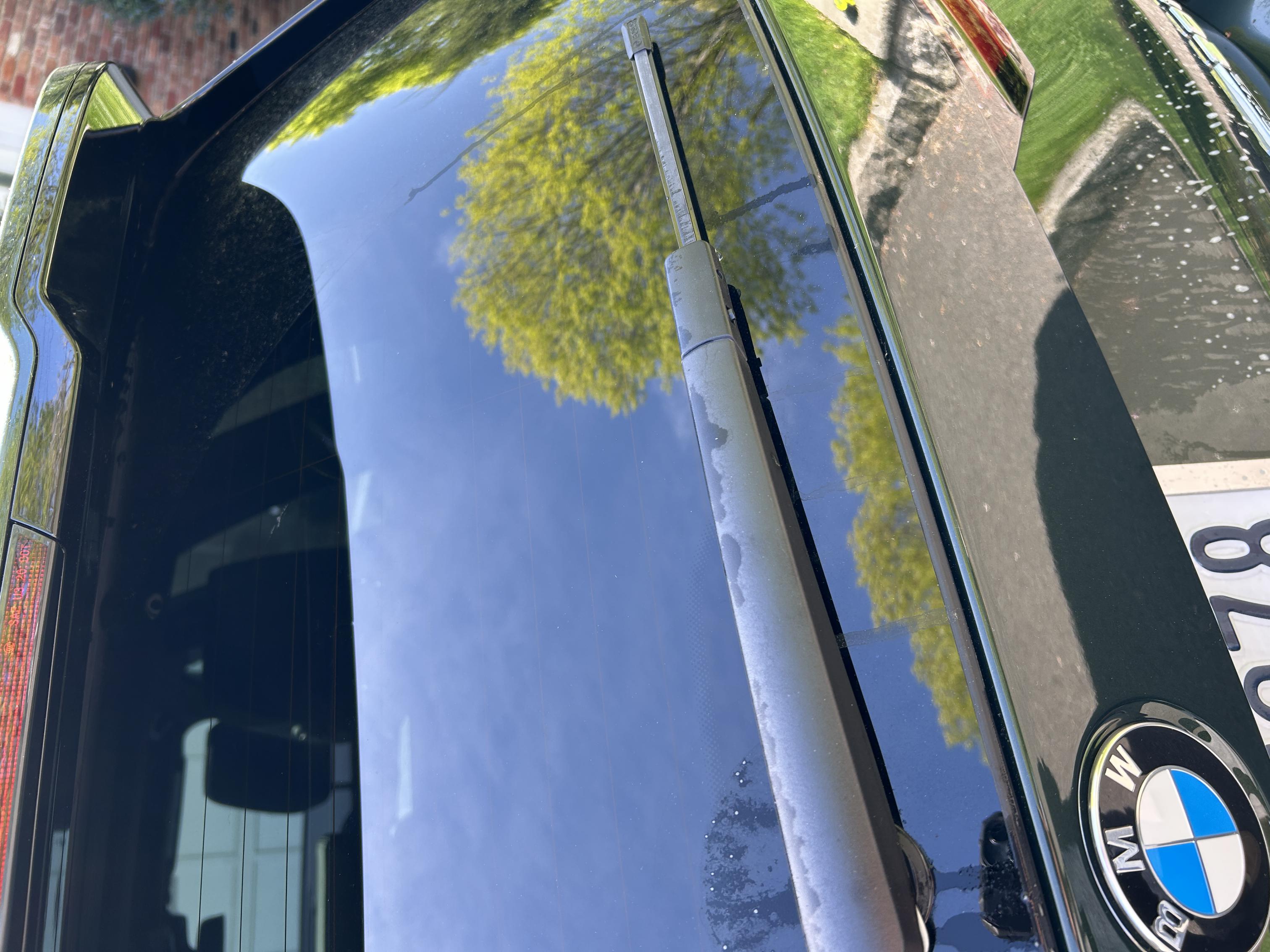

The rear arm is not a tilt design. Only lift slightly when sliding wiper out or you will damage something. Press locking tab down and wiggle blade left and right before pulling right and releasing blade from tang. Do NOT snap the wiper arm into glass.

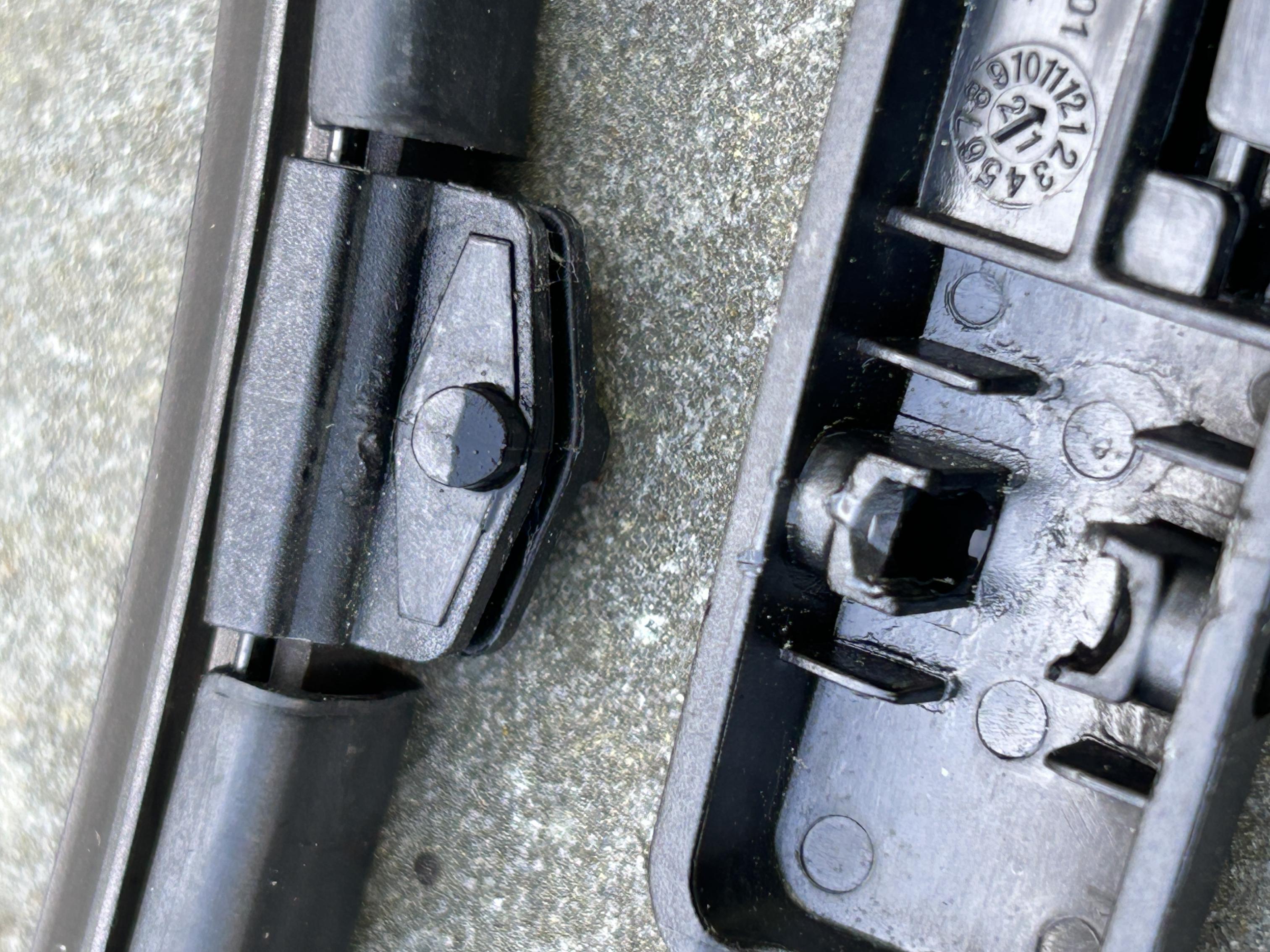

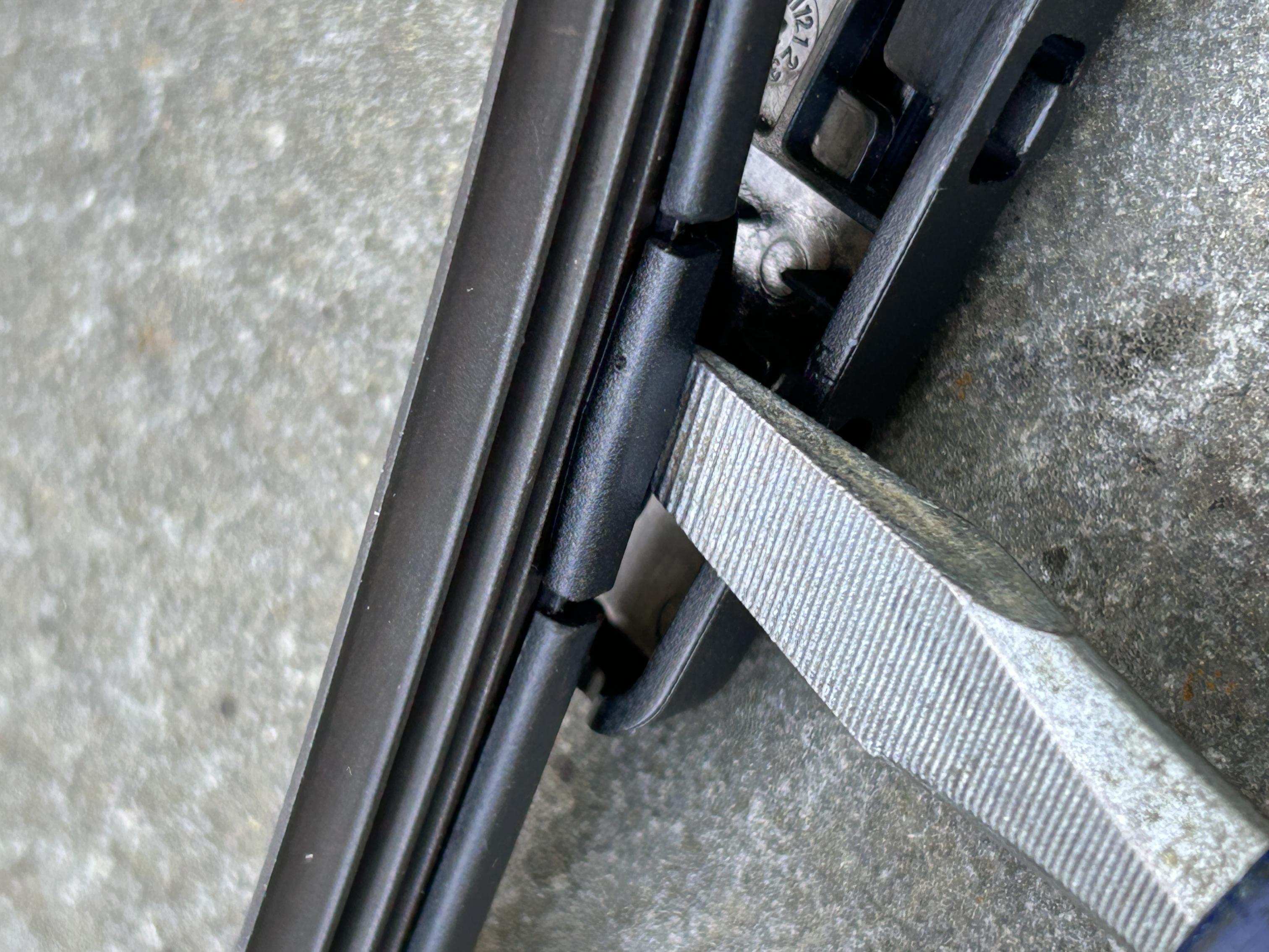

Reuse plastic pivot bracket. I used a flathead to carefully pry because Bosch has videos showing snapping out from joint. Plastic will break guaranteed so this is the hardest part. Installing, I was so paranoid that I lubed the ears before snapping new wiper back in. IMHO, the Bosch takes a lot more force to click in so lay the bracket on a piece of cardboard and center nipples before snapping in. Engage new wiper into tang and make sure locked. I noticed a gap in the contour of the rubber wiper and wasn't sure this will go away when it settles. Good luck and be extremely careful as NOT to break things.
